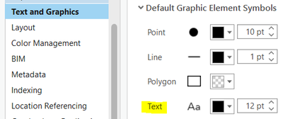

In ArcMap I had set up some standard/default text/font styles to use whenever I was labelling (either with Labels, or Annotations or just text on the Layout) for example streams and roads and such. So setting the font type, colour, size and orientation (left, middle, right).
I know in "Pro" there are Styles and I can add to my Favorite Style but I cant see where I then choose one of those when I am adding a text element.
JesseWickizer
As you've noted, the launcher arrow in the Graphics and Text group of the Insert ribbon tab opens the settings to set the project Default Graphic Element Text Symbol style. This style is used for all new graphic text created in the project and I generally keep this set to the text style I use most often.
Once you've added text to the layout you can use the style gallery in the Text ribbon tab to assign styles to selected graphic text. Once I have a text on my layout in the styles for my map, I'll often copy paste (or ctrl + drag) existing layout text with my desired style and update the text and position it where I need.

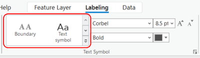

JesseWickizer
The Labeling ribbon contains the text symbol style gallery.
Select the label class in the table of contents, then click the Labeling ribbon. The text symbol style gallery is in the Text Symbol group.
Shaun_Dillon
Hi Jesse.
I see that for Labels but what when I just want to insert some text on the layout? - Using the Insert ribbon and then the Graphics and Text to choose Straight Text or Box Text or something. As I have found - to choose which type of text style I want I have to first click the little Properties arrow and then go in and then set the Default Graphic Element Symbols. It works but man its clunky (but then it is "Pro" so what do I expect but clunkyness).
JesseWickizer
