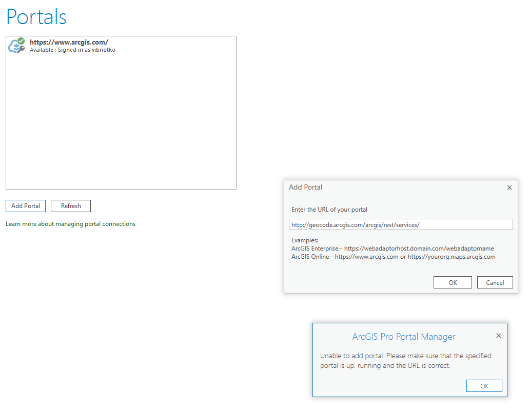

I have looked at the previous entries. It shows up in my profile settings and I can manually add to each product. Put I want it to be a default in each of my new products. When I try to add the portal, the image attached is what I get:

Hi Todd, you are trying to add a REST Service URL to your project's Enterprise Portal list. This will not work.
By default, the World Geocoding Service is listed under Locators
