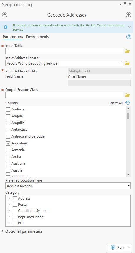

I know if you use the ArcGIS World Geocoding Service, there is a parameter for Country - see image below with Argentina selected.  I "think" this service would format addresses unique to Argentina but I have not tested it as of yet.  The ArcGIS World Geocoding Services does use Esri credits to process though.   I'm still researching the topic of creating one's own address locator and can it do the required formatting.

ArcGIS World Geocoding Service for Argentina have good performance to match and outputs formats, I tested it once, but use Esri credits;
The requirements wants with a cartography (a feature with geometry lines) create the Locator with the geoprocess the same name in ArcGIS Pro, and with that Locator, geocoding address later in a WebApp; I tested but when I use Create Locator, is missing in Country or Region: Argentina, so the outputs formats and address matches no very well.

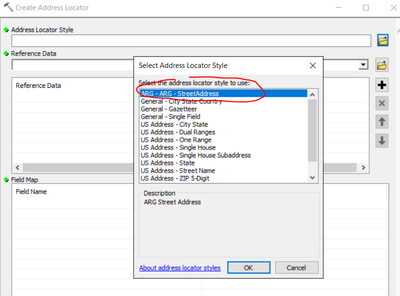

Because, In the past when I used "Create Address Locator" tool, I can select my file edited or another default styles (USAddress) in Address Locator Style option, I show an example I did in the past (The ARG-ARG-StreetAddress is a copy from USAddress file edited by me):
In ArcGIS Pro, When I use "Create Locator" I can't chose my style file edited, so I erase the USAddress.lot.xml default and paste my style file .XML edited in folder respective; but I'm not seeing changes in geocoding results, both output formats and address matches; so I thought the USAddress.lot.xml file edited no working in ArcGIS Pro, or maybe I need to do another modifications to change address format output because I want to get street name first and house number second.
