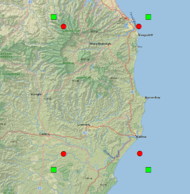

Please see the screen shots. I can see that the extents aren't matching but I am struggling to fix this.
The first point file was imported via XY data from excel
Thank you in advance.

One is in a geographic coordinate system and the other is a projected one.
Your second one seems to be an event theme, you should convert it a featureclass in a file geodatabase.
I would check that both then have a properly defined coordinate system at that point.  If they do, they should project on the fly in a map.  If they don't, then one of them was defined incorrectly.
I would also check the point layer's x, y values to see if they make sense

I believe the XY coordinates from Excel is in "WGS_1984_UTM_Zone_56S". Kindly use this coordinate system while creating the Event Layer from the Excel.
Once the data lies properly, you may reproject the coordinate system to a desired one using Project tool.

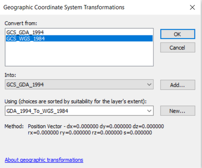

If prompted for transformation (while adding the second layer to Map), you could use the following transformation method.

I took the coordinate values from the extent of your layer (from XY Table), and I created a CSV file with 4 values.
First I defined GDA_1994_Albers as the coordinate system (Make XY Event Layer). That didn't go as per the expected resultant.
Then I thought of using some commonly known Projected Coordinate Systems like UTM_WGS_1984 and Web Mercator (Auxiliary Sphere).
As per the extent of your shapefile, 56S is the correct UTM Zone for the area. When I defined the same coordinate system, while creating the XY Event Layer. The event layer was overlaying on top of the shapefile's extent.
