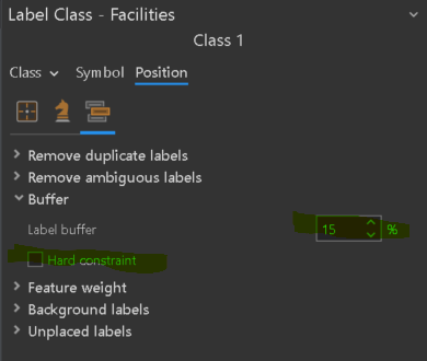

Hello Brenda, in the labeling pane, under the Position tab, you should be able to set a buffer, which will space the labels, and check hard constraint (if you want the buffer applied 100%).
