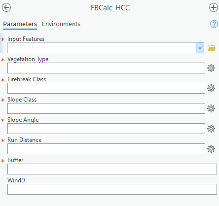

Hi everyone,
I have created a script in ArcGIS Notebooks which I want to connect to a custom script tool (pictured). Note that the  tool pictured below is stored in a toolbox which can be accessed from the catalog pane.
When I drag the script tool into notebooks it looks like this -
"C:\\Users\\Kedaravindan Bhaskar\\Documents\\ArcGIS\\Projects\\FBM_research\\FBTool\\firebreak.tbx\\FBCalc"
 Rather than -
arcpy.management.ReclassifyField()
Basically, I want the script tool to accept input output parameters within Notebooks as in other script tools that come with ArcGIS Pro.
How can I get this script tool to accept input/output parameters within the notrbooks environment?
Please let me know if you need anything else from me. Thank you
Warm regards, Kedar
Luke_Pinner
MVP Regular Contributor
Use arcpy.ImportToolbox:
toolbox = "C:\\Users\\Kedaravindan Bhaskar\\Documents\\ArcGIS\\Projects\\FBM_research\\FBTool\\firebreak.tbx"
arcpy.ImportToolbox(toolbox, "firebreak")
arcpy.FBCalc_firebreak(tool, parameters, etc...)
