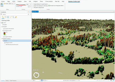

Are you able to do something like this?
AndreasHall
You should use your raster both as an elevation surface and as a 2D raster layer.
To add it as a ground layer, right click Ground in your table of content and choose Add Elevation Source Layer. Then, select your raster.
If you want to apply an vertical exaggeration, select ground in the contents pane, then go to the Elevation Surface Layer tab and apply an exaggeration.
Make sure you have your layer added as a normal raster layer to your scene as well. Like in the image above, my raster layer skogjord_ndsm, is present both as an elevation layer and as an 2D raster layer.
Does this help?
