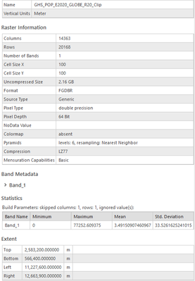

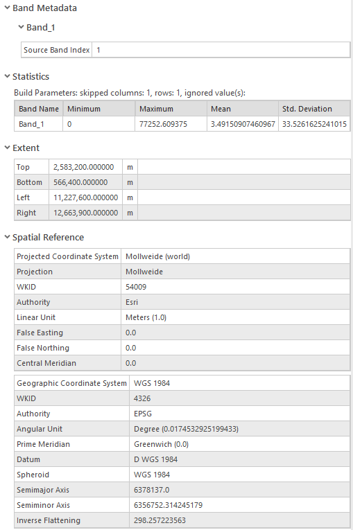

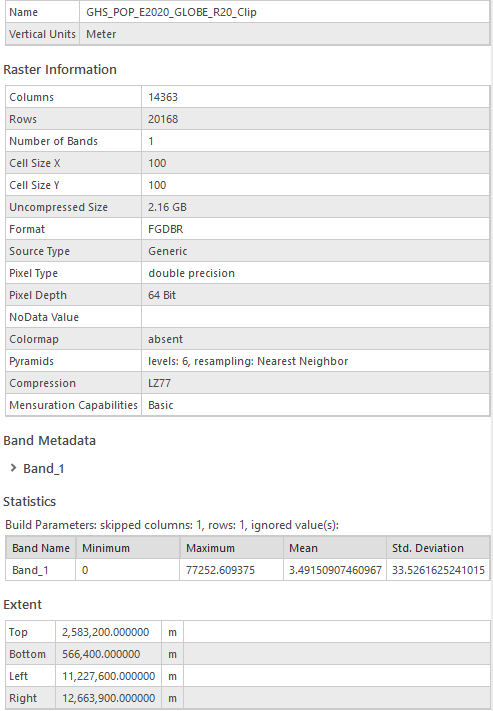

What I'm trying to do is get a summary of cells per country in reference to density. I was hoping to try and export this data and run some analysis similar to the paper "MEASURING ECONOMIC GROWTH FROM OUTER SPACE" (Henderson, J. Vernon, Adam Storeygard and David N. Weil. 2012.)
Country IDCell_0Cell_1-900Cell_901-4000Cell_4000-20000Cell_20000-80000Total
PH31265421564128656075354353512
I was hoping that I could export the data into something that would look like this as so I could export It as a csv and run it using other programs.
Below is some additional data as well as the source
https://ghsl.jrc.ec.europa.eu/download.php

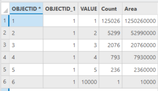

Hi, there might be better solutions than this but this is how I did it:
  1. I used Remap raster function to recalculate the raster values. You have five classes in your example so you would recalculate to values 1-5.
  2. I exported the resulting layer to a folder.
  3. I used the exported raster and country polygons as input to Tabulate Area (Spatial Analyst)—ArcGIS Pro | Documentation
Result:
(It is also possible to get a table with one row and one column for each raster value.)
