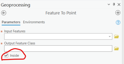

Have you tried running the tool with Inside checked?
Burakkucuk
Thanks a lot!
