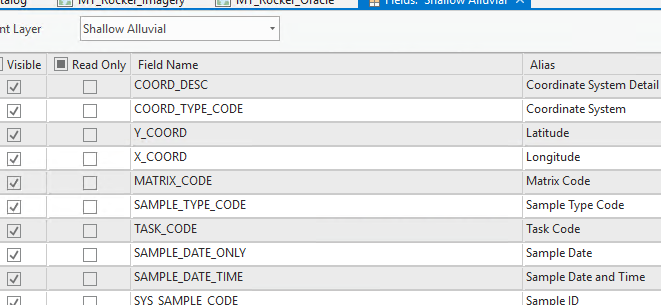

I just need the fields to sort as they do in the table. My situation is that I need to update a BUNCH of aliases. They all disappeared when I had to drop a join. In the image below, the above half is a table whose aliases I want to copy. It has the same fields as what I'm updating, in the same order.
The below half of the image shows the order that the field view puts the fields in. They are in a completely different order - not the order they are in in the table. It would take forever to hunt down the right field, update its alias, then search out the next field...

Hi Randy,
Well, I took a look at this in 2.5 and I do see the issue that you're describing.
While I realize it doesn't solve the problem today (and I do apologize for that, I realize it is frustrating), I did some testing in a current build of ArcGIS Pro 2.6 and it appears that the work done on Fields View has taken care of the issue described here.
Here is a short video to show you what I tested so that you can validate that is what you're trying to do.
FieldsView_ATView_Field_Order_sync
Take a look and let me know if the issue appears to be resolved in the video.  That will help ensure that we understand the problem, and validate that it has been fixed.
In terms of figuring out the sort logic in 2.5, here is what I see with a join in place:
This is an oversimplified test-case as I just exported a feature class to table in order to create an easy join, but I wanted to share what I'm seeing as it appears to match what you're seeing in terms of the origin table field being placed together with the destination table field:
