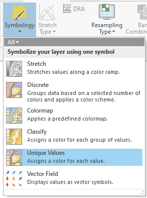

I can't remember what that old page said, but this seems to work. Select your layer in the TOC, then in the Symbology drop down choose Unique Values. It should keep the same colors.

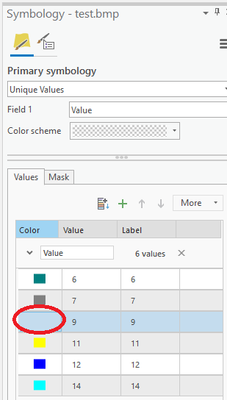

Then in the Symbology panel you should be able to click on individual colors and change them to No Color.

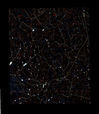

I need a solution to this as well, as the link is gone. We use USGS topographic maps as our base-maps and there is no way to easily make it so the white background is set to no color. Is there any way to edit internal colormaps in Pro, it says to click to modify symbol but yet doesn't allow me to? It was really easy to do in ArcMap just right click the color you wanted to change and change the color, in Pro it doesn't let me change the colors in symbology. A workaround I've found is to the open the topographic map in ArcMap then set the white background value to 'No color' then save that as a layer file, then in Pro 'Import from layer file' to get the correct symbology. It works, but it is an inconvenience, especially since every topographic map has a different value for the white background so for every quadrangle you would have to go through this process. Below is an example of importing a layer file to a different quadrangle than the original layer file was created from... Any tips?
