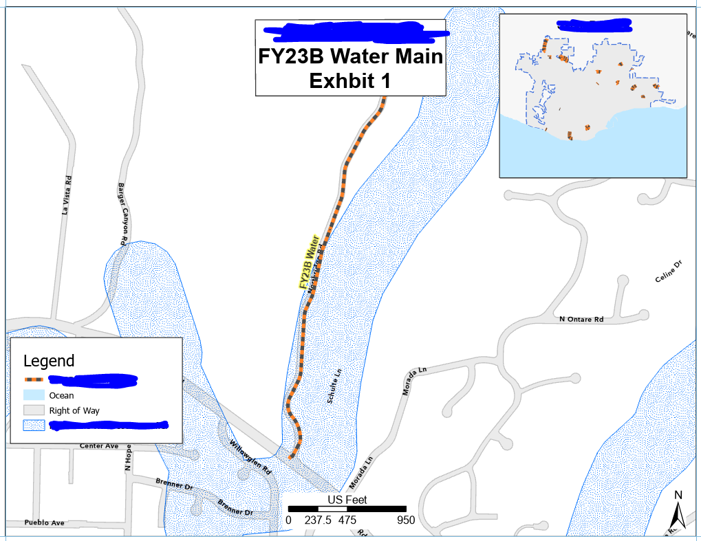

I have a bunch of bookmarks that I use to build a pdf map layout of project locations. I use the map series bookmark option to tell Pro what is going to be in the map. Bookmark = Page in PDF map series.
I have added an inset map on each page (bookmark) for each project location on the map series map which I would like to have automate a red highlight box around the segment that is in the bookmark frame in the inset map.
Or only display the segment that is in the map frame in the inset map. Preferably the first option.
Is there a way to automate this?
How the map currently looks:

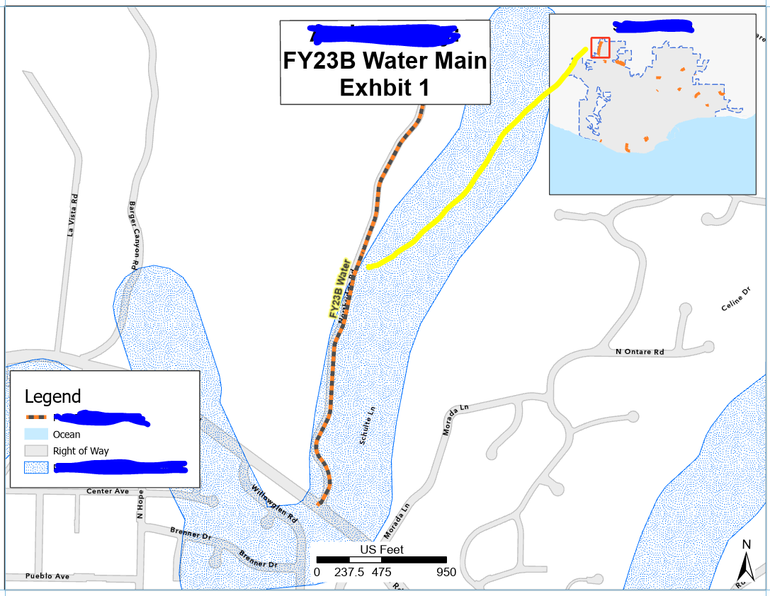

What I would like automatically done (dependent on segment within map frame):

I think you are looking for "Extent Indicators" in Pro
https://pro.arcgis.com/en/pro-app/latest/help/layouts/extent-indicators.htm
ChrisSpadi
That was it. Thank you. Thought I remember using it a while back, just couldn't remember if it was custom or an off the shelf feature.
