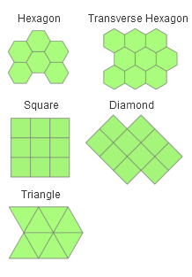

It is probably useful to think of grids. All of these grids can be created by the Generate Tesselation tool:
A raster by definition is a square grid* and computation is optimised based on that. Rasters just can’t be other grid types.
* Rasters can be created with different x and y cell sizes (a rectangular grid) but they are generally not supported by ArcGIS and may be automatically converted back to a square grid when using them in tools.
