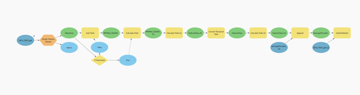

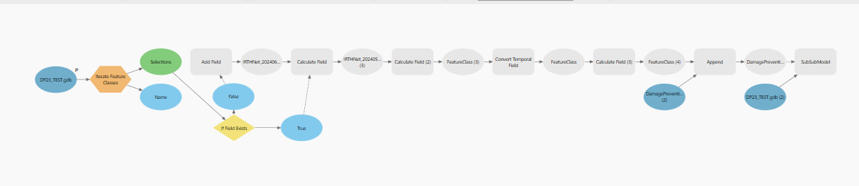

Hello all,
So, I have this model, and so far, it runs pretty well (rare anomalous failure here and there).
However, because of updates to the source data I need to get this model to run with an "If Field Exists" logic. Basically, I want the model to iterate though some feature classes, and if a field exists, I want it to calculate another field and continue on with the downline processes. If the field does not exist, I want the model to add the field, then calculate the field and continue on with downline processes. I've set both True and False as preconditions for the processes I want them to carry out, but nothing downline will validate.
And if I try to reconnect the output (i.e. "Selections") to the "Add Field" tool, the model will validate but will generate an empty output because all the Inputs are not current.
I'm lost in the sauce over here. Please help! Thank you!

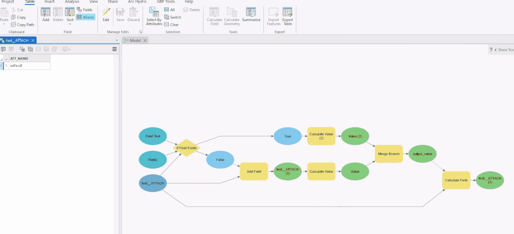

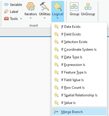

What you all want is the Calculate Value and the Merge Branch function.
Merge Branch takes whatever branches you feed it and it outputs either True or False. The tough thing with it is that if, for example, you feed it the updated table from "Add Field", but you didn't create an updated table because you didn't need to add the field, you get a False as a result. Which, if you use as a precondition to Calculate Field, you won't be able to calculate the dang field. So we have to get a little creative:
Calculate Value lets you set create a variable of any value you choose. In this case, I use it twice (once for each path) and calculate the same value of True to feed to Merge Branch.
Check the gif below, where I use this to add the field and calculate it, then I change the calculation expression when I run it again and don't have to add the field.

A few things to note as you read through:
1) Model builder apparently will try to execute everything, even when it doesn't have to. So you get a couple warnings because it can't do the stuff on the False path, for example.
2) More importantly, this works by feeding it the table and calculating the field. You can do that in this specific case because Add Field returns an updated table, so either way you're feeding Calculate the same thing. This is why I get an "All the inputs not current" warning. Other uses might not work so easily.
See the attached ATBX for the model I used for this.
