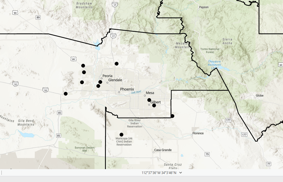

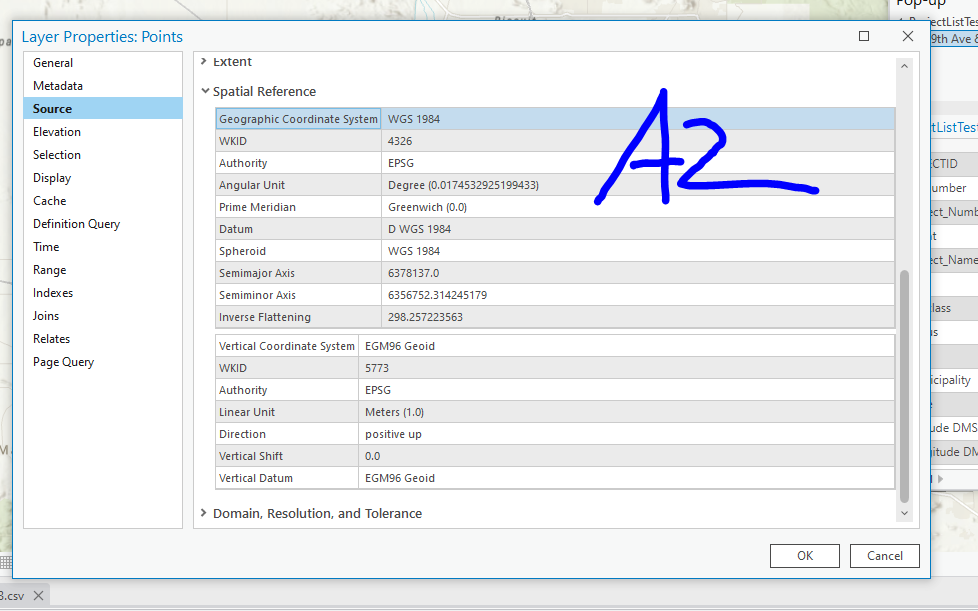

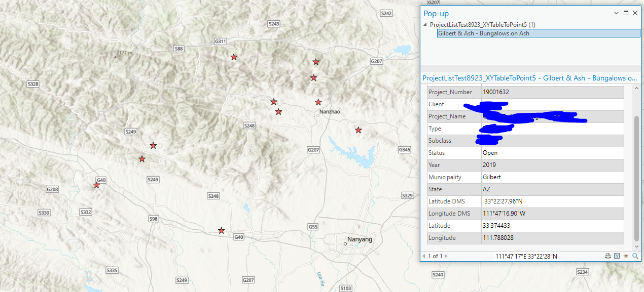

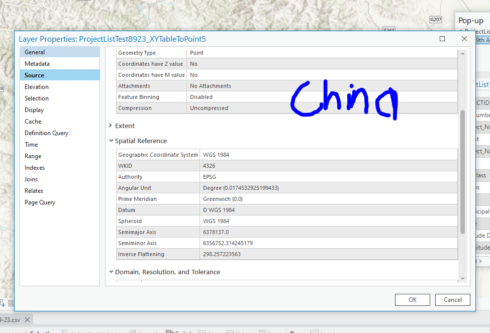

I have a data set of projects that I am trying to easily map using lat long from an excel file. We have points from a Google Earth file (.kml) that I took the lat/long from and put into an excel file. I saved as an .csv file and brought into ArcPro for Desktop.  When I run the Display XY Data command it is putting the points in China. I have checked the projections and datum, have tried different ones, but I cannot get them to overlay in AZ like they are supposed to.
I checked manually the .csv file and that the field is set to double. I also imported the Google Earth file (.kml) into to project using the same settings and they overlay perfectly.  The goal is to have a huge running excel file that can be joined/related as new projects are added to the list with their coordinates.
The geodatabase feature class is set to NAD 1983 HARN StatePlane Arizona Central FIPS 0202 (Intl Feet). The points were brought in from Degrees and converted to decimal. Ive tried re-projecting and have had no luck.

@ElliottBAR add a negative to your longitude values. For eg. reading from your example I used 33.3744, -111.78 and they landed near Phoenix, AZ.

Wow! Thanks so much - big life saver! What a dumb miss on my part. I was so careful to check my excel files and .csv formats, that I didnt check the original excel where the data was coming from. The column was removing the - sign in front! Thanks for the help and getting me back on track!
