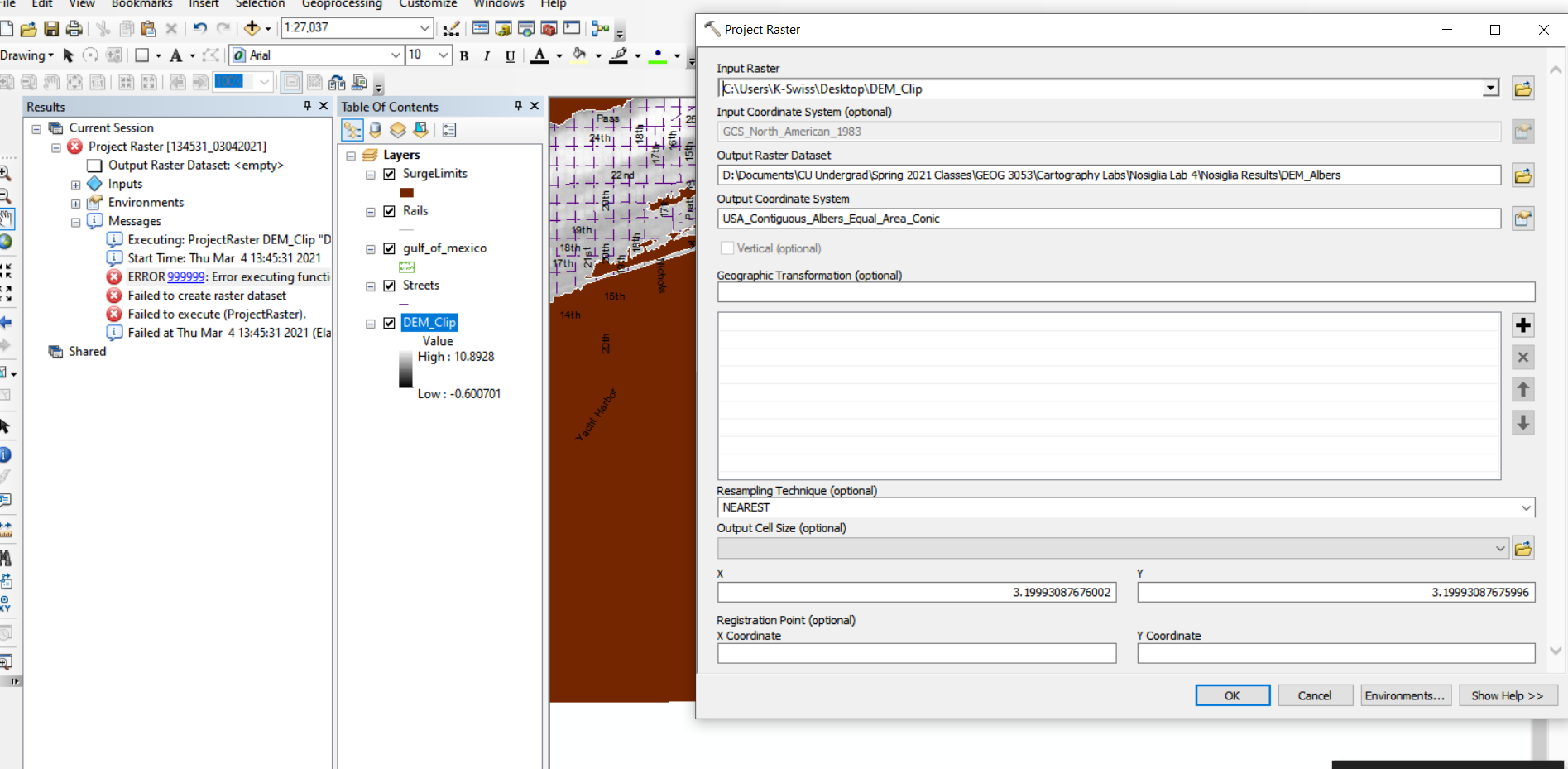

Hey guys, I'm trying to use the Project raster tool to make a cubic transformation of the raster I'm working with but the task continues to fail to execute. I faced the same issue when trying to clip the raster. This leads me to think there is an issue internally with my computer or software. If anyone has any ideas of how to get around this it would be greatly appreciated. Here's a picture of the inputs I have set before I run the tool.

I can't see the filetype of the input raster, and it's not within an FGDB it seems.  What format is it?
Also the same for your output raster, perhaps specify .tif as an extension (worth a try).

Your output raster file path is trying to create an esri grid in a folder with spaces in it.  That won't work.
Specify a realistic/shorter path with no spaces or other unsavory characters and specify a *.tif format (esri's preferred format.
eg  c:\myproject\projected.tif

Great it worked! Looks like I just had to specify the output raster to .tif    Thanks for the help guys.
