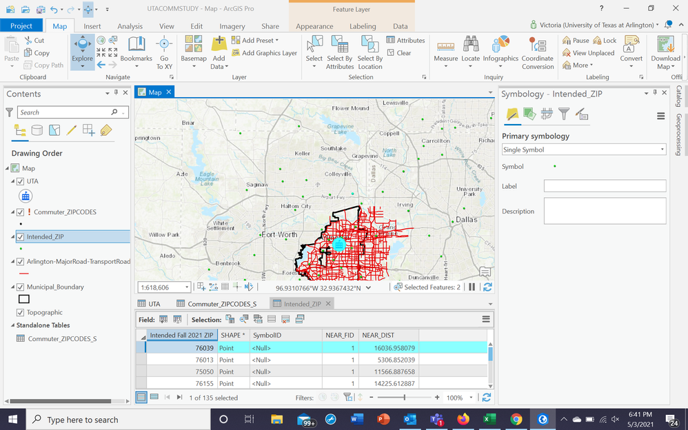

I am working off of ArcGIS Pro 2.7.0. I am trying to find the distance in miles from multiple zip codes to a school. Any help would be beneficial!

Thank you! NEAR_DISTNEAR_DISTHow do I simplify them down? I'm getting big numbers.

I'm not sure what you mean.  What projection/coordinate system is the map and data in?
It would be values of those units of measure, I suspect meters in this case i.e. 16036m -> 16.036km, use the measure tool to check this.
