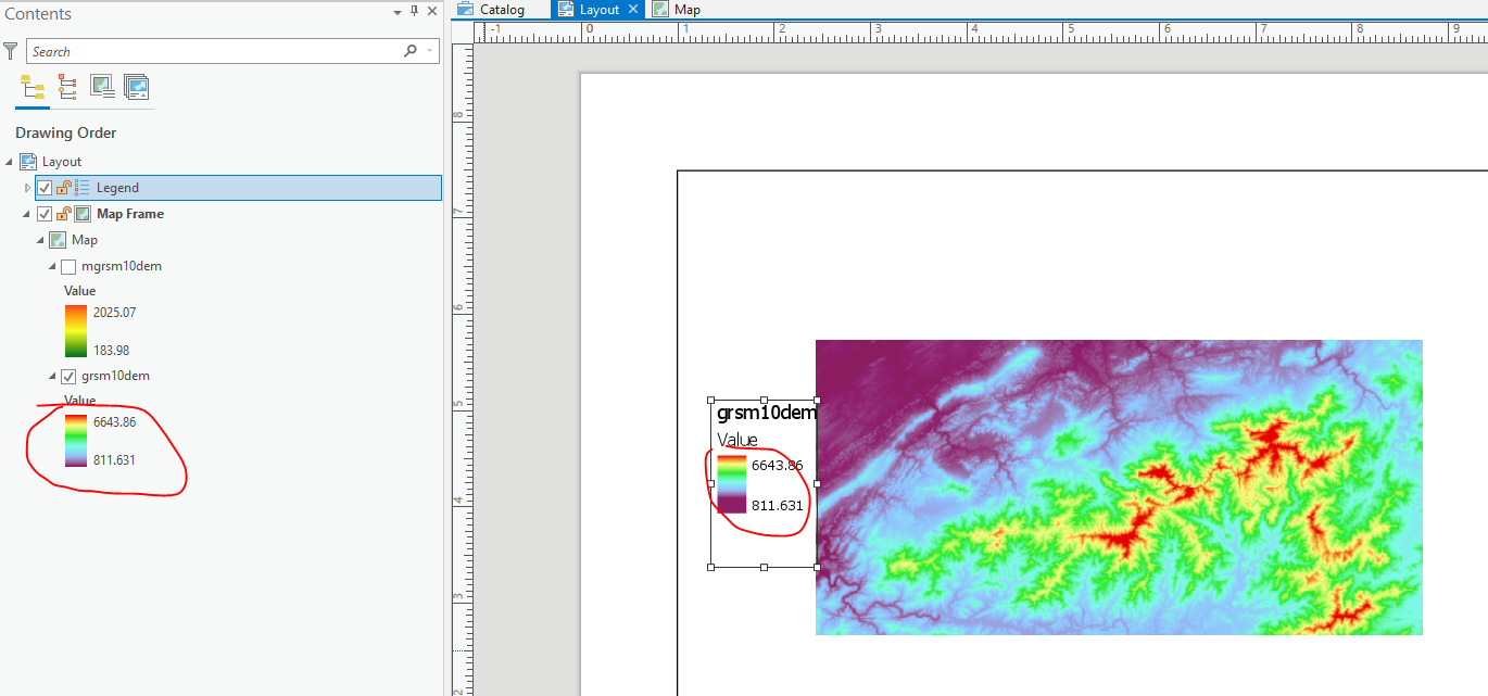

Hi.
I can't fix the following issue in AcrGIS Pro (v.2.2.4 😞
I have a continuous color ramp for map's elevation, and when I create a Layout with a legend, the legend's color ramp doesn't match the elevation layer. Particularly, the minimum value occupies ~20% of the legend.
Please see attached below. This error is persistent in different project and with different colors.
Anyone came across this issue and found a solution?

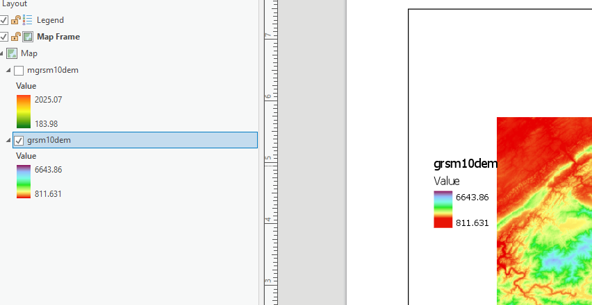

ThomasColson
MVP Alum
Kory Kramer‌ I see something similar in 2.3.1, albeit not with all color ramps. Note in my TOC, the purple is a narrower band than in the legend.
If I reverse the color scheme, same effect
And here's something really whacky....when I start playing with settings, note how the legend element resizes itself.....
(view in My Videos)
The reason why....note how the number of decimal places is changing based on changing statistics, despite the "Label" only showing 3 decimal places. Even if I change the label, the legend item continues to throw many decimal places into the label when changing the statistics type.

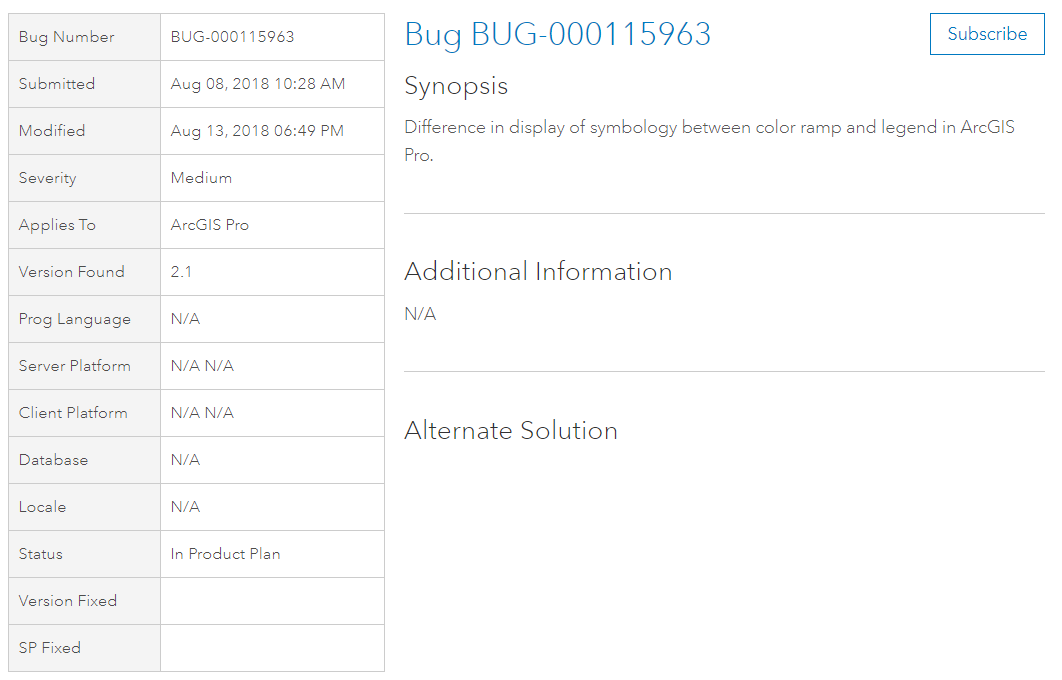

KoryKramer
Esri Esteemed Contributor
Looks like it is BUG-000115963: Difference in display of symbology between color ram..
You could subscribe to that, and if it is really affecting your workflow, I'd recommend contacting support to get attached to the bug.
