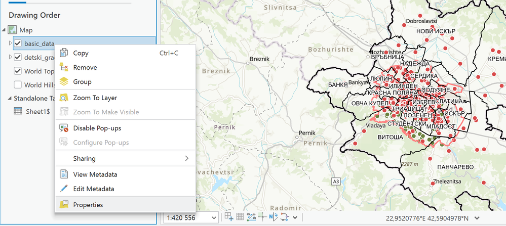

МартинТабанджов
Hello again,
Again I am facing problems with joining the population table to the main layer. For some reason its not lettin me to join and relate the dataScreenshot 2026-01-18 161410.png
VenkataKondepati
Honored Contributor
Hi @МартинТабанджов,
I think you are trying to do at a group layer instead of feature layer.
Please expand the basic_data and try. It should so you the options.
or you can also get join tool using steps below.
Open the Tool: Go to the Analysis tab > Tools and search for Add Join.
Please let me know if this helps.
