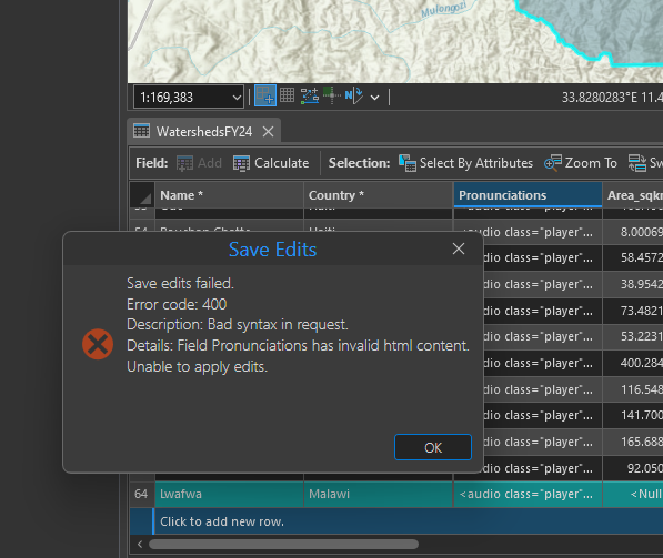

Since the most recent update, I am not able to save my html code in the attribute table for an audio player.
I have a specific column set up for the html code for my audio player. Every polygon has it except the newest polygon I added. But when I go to add the html code I get an error shown in the image when I save. I haven't figured a way around it yet.
When I click okay, it clears my code.  I am so sad. I had this working really well for our organization.
Anyone else experience this?

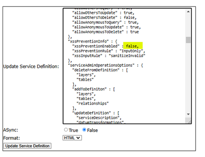

I did a repro of what you are experiencing, and found that setting xssPreventionEnabled to false, allow HTML to be entered.
Here is more information about the security setting  https://enterprise.arcgis.com/en/server/10.9.1/administer/windows/best-practices-for-configuring-a-s...

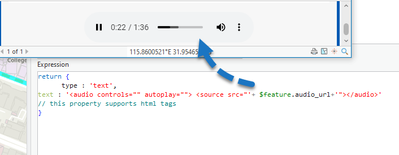

How are you actually using the HTML in your attribute?  If it is just for the popup, it might be better to do the HTML in the popup definition, and just put the URL in for the attribute.  You could use Arcade in your popup definition to create the HTML for use in the Popup.

You, my friend @MarkBockenhauer, are a life saver!! By switching the xssPreventionEnabled to false allowed me to enter in my html code again in the attribute table. Thank you so much for the help!
