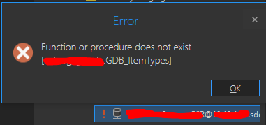

We are able to connect to and synchronize the one-way replica just fine from ArcMap's ArcCatalog view (Python 2.7 based) and can access the SDE feature classes without issue. However, if I attempt to connect to the SDE connection within Pro's Catalog Pane, I can not access the SDE connection and get the following error:
"Function or procedure does not exist [DatabaseName.GDB_ItemTypes]"

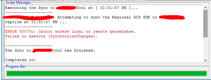

If I attempt to synchronize that PostgreSQL SDE connection with Esri's Python 3.x libraries, I get the following error message:
"ERROR 000791: Cannot access local or remote geodatabse. Failed to execute (SynchronizeChanges)."

Yes we have noticed a similar issue connecting to older geodatabases within the Pro Catalog Pane specific to upgrading to Pro 2.6. Our postgres databases created with 10.1 and 10.2 tend to get this error whenever we attempt to connect to them, whereas our newer databases in 10.4 through 10.7 mostly work fine (as far as I can tell). It may also have to do with the version of postgres on those older servers, which is quite old (9.0.3), whereas our newer databases are on newer versions of postgres 9 or 10. This error is mostly persistent but somewhat intermittent in Pro (some databases sometimes work, others never work), while connections in ArcMap 10.6 and 10.6.1 still work fine.
