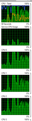

Here is  some moderate usage with my work computer
This is with 4 cores and 8 logical processors
