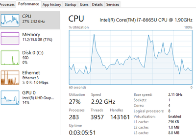

your desktop that takes 10 seconds, you must be copying these down from a network share first before processing?  And the laptop is doing it directly from the share?
i know where they are using arcGIS here, running models from network shares is suuuper slow, and has nothing to do with your hardware.
The only other difference would be if you are getting thermal throttling occurring on your PC, another common issue, but would not address a 10minute vs 10second processing time.  I would try copying the models down first then running it.  If that speeds processing time, then running a sync process rather than opening these directly from a share would likely be helpful.
I say this based on the performance chart of ethernet spike > downloading models > disk spike > ram offload models to disk. i'm no expert on arcgis, its just what ive observed.
