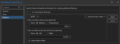

Hi, I want to know the purpose of Vertex before offset and what is the benefit of it.
DanPatterson
MVP Esteemed Contributor
appears several times, its description can be found in one of those, for example, look at what it does in this dialog
Point at every vertex—ArcGIS Pro | Documentation
