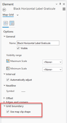

Can you check the Grid boundary and make sure Use map clip shape is checked?
Cheers,
Aubri
cr3
It is checked.
AubriOtis
Interesting. That was the first thing I thought of. This could be a data problem, a crazy border thing, or just a straight up bug. I think tech support would be most helpful here because they can look at your project directly and really troubleshoot.
