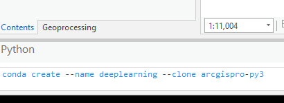

In the ArcPro Python window (as shown above) entering them and hitting return doesn't seem to have a result?
I deleted my earlier cloned environments and restarted ArcPro.
WilliamHarbert
Here is what I am trying from the python window--with no activity after hitting return:
Nothing seems to happen?

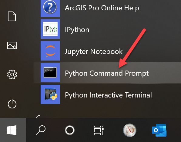

DanPatterson_Retired
MVP Emeritus
You have to do it from within "conda" not the python window in Pro
This will get you there.  But make sure you have the environment you want set in Pro before you go there (and shut down Pro as well)
