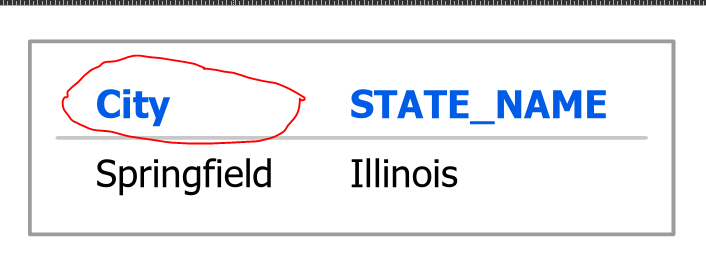

If the field name has an alias the Table Frame header will use that alias. For example, below I have a Table Frame that shows 2 columns.

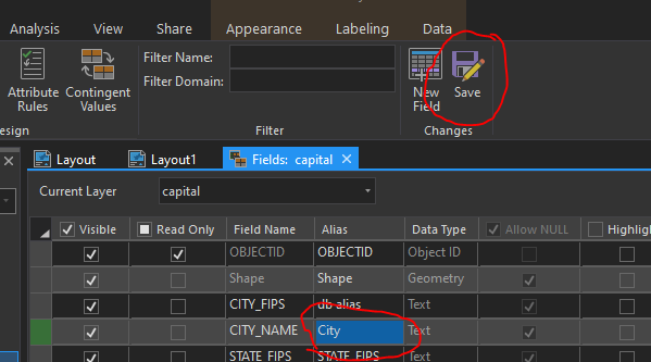

The Fields View looks like this. I've underlined the fields displayed in the Table Frame.
The Table Frame should be pulling the Alias value.  If you edit the text you will need to save the change before it is registered by the Table Frame. For example, I've deleted "Alias" from the text value in the Fields View for the source feature class,
The Table Frame automatically updates.

Hi Olivia,
If you are saving the changes to the Fields tab, or if there is a pre-existing alias that the Table Frame is ignoring, I would consider this a bug and would contact Esri Support. They are better equipped to handle troubleshooting steps and gather bug data. They can be contacted at https://support.esri.com/en/contact-tech-support.

La_Olivia
Thanks Tom. From your instructions, I realized that I was not hitting Save after making changes to the Alias. The alias names are now showing up in the header of my Table in the Layout. Thanks again.
