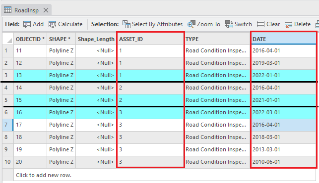

Is there an OOTB geoprocessing tool that can be used to select the greatest 1 per group in a FGDB table?
For example, for a given ASSET_ID, select the road inspection that has the latest date.
