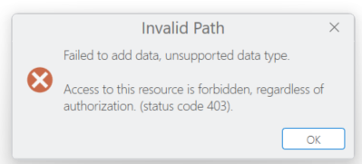

Thank you for the reply but my every attempt gives me this prompt.
Andrew--Johnson
Hi,
Which version of ArcGIS Pro are you using? Also, you confirmed you are using the correct API key you purchased from Google?
thanks,
Andrew
MillionMap
Running ArcGIS Pro 3.4.3
The world of API keys is a new venture for me, so learning as I go along.  I've set everything up, select what I think I need, I get provided with a key but still no success when I use it in Arc.  There are so many APIs and Services, I'm not sure if I'm choosing the correct one.
Andrew--Johnson
Hi,
Looks like it's not working because you are on version 3.4.3. This a new feature in ArcGIS Pro 3.5 so please update to that version in order to use it.
thanks!
Andrew
MillionMap
Upgraded to 3.5 and it solved the issue.  Thanks.
