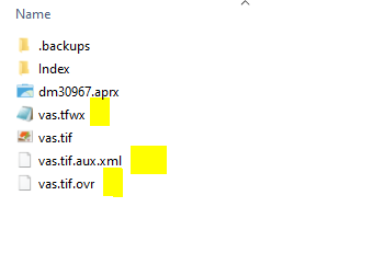

Sometimes, it's best to get out of ArcGIS Pro, and start the process over.  But before you do that, use your Windows File Explorer and navigate to the directory/folder where the tif image resides. Delete the .tfwx, .aux, and .ovr files.
Notice that I've used notepad to open the .tfwx file: it's just a text file that equates to the old style 'world file' that holds the coordinates of one of the corners of the image...
That should just about do it....

Thanks, but I've tried and I doesn't change anything. In fact, if now I open the image and the GCPs I picked yesterday, they doesn't georeference the image anymore neither when I'm still in the georeferencing process. They appear to be all in the same location
