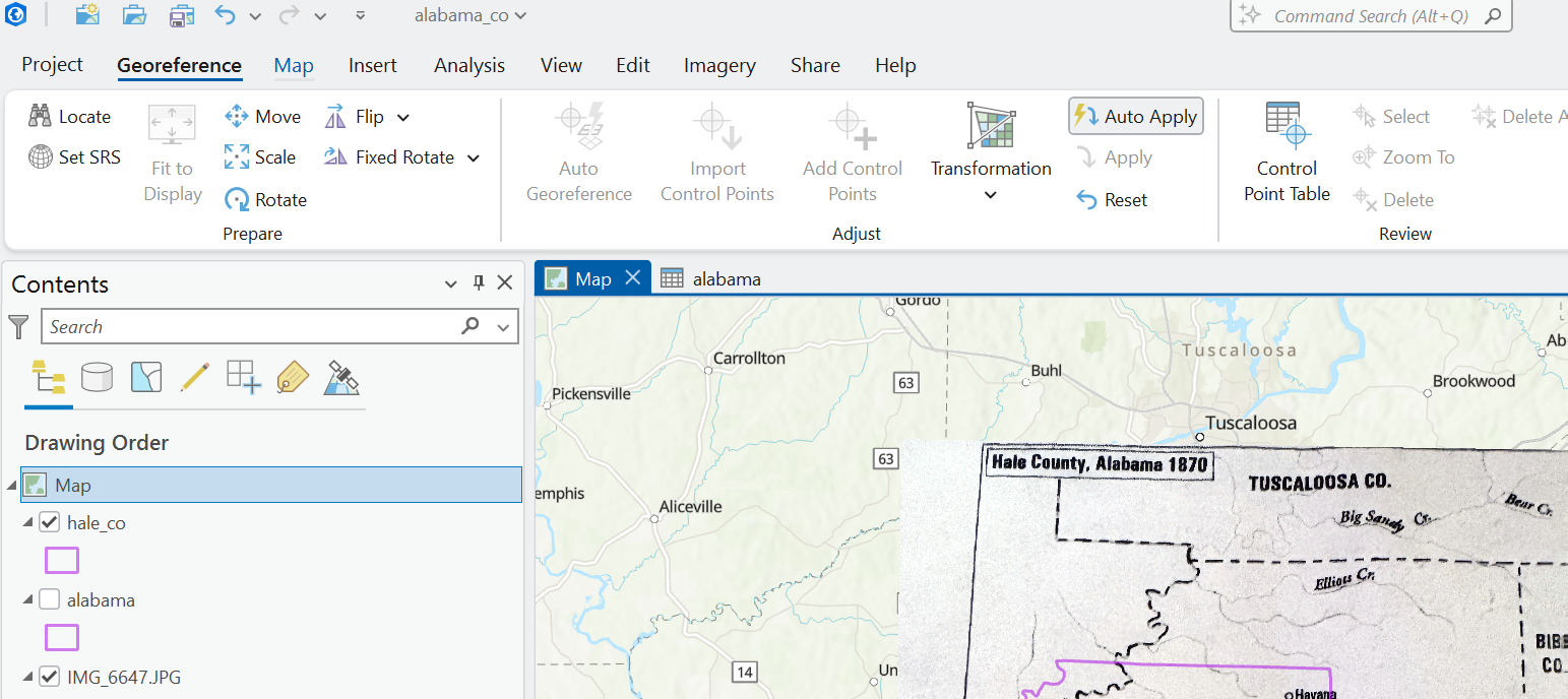

I'm running into an issue in ArcGIS Pro (latest version) - I'm trying to georeference an image, and I'm able to add control points until I change the Coordinate/Projected System. For example:
  • Add an image
  • Add some control points - save the Image
  • Close out the Georeference window
  • Switch to a different Coordinate or Projected System (any one)
  • If you reopen the Georeference panel for the image - most of the Georeference panel is grayed out
Any thoughts? I've been finding the only way to reactivate the buttons is to completely delete the image and start from scratch again. I know in the past I was able to re-add control points multiple times, so it's a little odd.

SaraJL
@RTPL_AU I think the main challenge was the image that is being used for referencing - there wasn't a projection or coordinate system that was noted for that particular image. So I had to do some guess work a bit - but it ended up not quite working, so I needed to switch it to something else.
In the past - I didn't run into the issue where the panel would completely lock out. For example - I had to create some post-WW2 boundaries of Germany and France for a client's book project once, and that also required a little bit of guesswork because the historical map image didn't quite fit with the typical Mercator projection. So I could close the georeferencing panel, try a different projection, and then when I reopened the georeferencing I would usually have to redo the control points, but the entire panel wouldn't be grayed out.
In this case, the only way I could reactivate anything was to completely delete the image and re-add a new one from scratch. I couldn't even switch back to the previous projection to reactivate the panel, which was a little odd. It was almost like it was caching information in some weird way.
