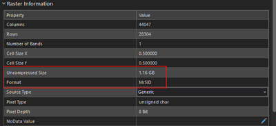

What type of imagery are you georeferencing?  It may be a highly compressed image format, such as a SID.  Take a look at the properties of the raster by right-clicking on it in the Catalog pane > Properties.  It will list the uncompressed size there:
ArcMap/Pro cannot write to all output types, so it will uncompress the image.
