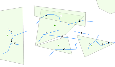

I have a multi-part road polyline FC. For the longest part of a given polyline, I want to use the line/part's midpoint to get the WARD_ID of the closest polygon (single-part polygon FC).
  • The WARD polygons aren't topologically clean. There are slight overlaps and gaps. So that's why I want to get the closest polygon -- within a 30m tolerance.

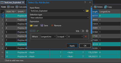

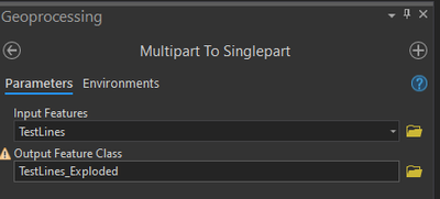

  • Explode the multipart features

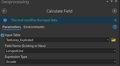

  • Calculate a new field that tells you whether a singlepart line is the longest part of a multipart feature
var id = $feature.ORIG_FID
var fs = $featureset
var all_line_parts = Filter(fs, "ORIG_FID = @ID")
if($feature.Shape_Length == Max(all_line_parts, "Shape_Length")) {
    return 1
return 0
  • select and delete all exploded lines where "LongestLine = 0"

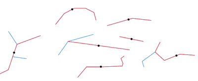

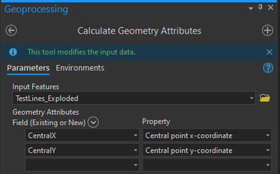

  • Calculate the central point coordinates
    • This is not actually the midpoint.  This is what the tool help says:
    • "This point is the same as the centroid if the centroid is inside the feature, otherwise it is an inner label point."
    • But it's probably the best you're going to get without pretty large code blocks...JohannesLindner_3-1653460466851.png

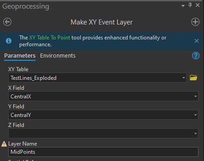

  • Convert to points
  • export to actual point feature class

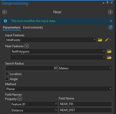

  • Find nearby polygon features

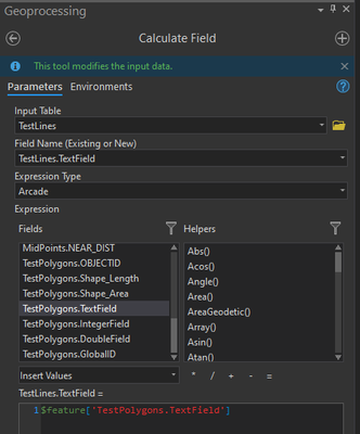

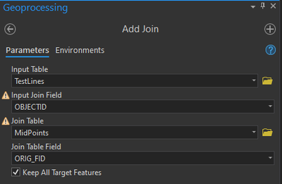

  •  Join MidPoints to the original Line FC using "OBJECTID = ORIG_FID"

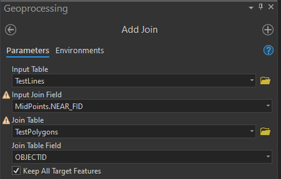

  • Add the polygons to that join, using "MidPoints.NEAR_FID = OBJECTID"
  • Calculate the PolygonID field
  • Remove all joins

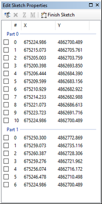

In that case, it might be possible to go back and convert the multiparts to single parts. But it would take a lot of work to review/fix any linear referencing events that are tied to the geometry/M-values of those roads.

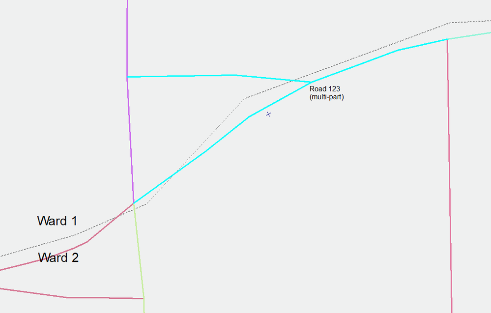

I want to be able to control what part of a given multi-part line was used to get the Ward number.
  • So, for Road 123 (multi-part), I want to use the main part of the road (the longest part) to get the Ward number, since that's the part of the road I care about. I don't want to use the turning lane to determine the ward number, since it's just a secondary portion of the road, and technically falls in a different ward.
  • Likewise, I want to use the midpoint of the main part of the road, because I think the midpoint is most likely to be in the correct ward. Whereas, say, the startpoint of the smaller part is in a different ward.
In some cases, simply using the midpoint of the entire line might work. Maybe the midpoint would have still fallen on the main part of the road, and within the correct ward. But I didn't want to assume that it would always work like that. And with GP tools like Feature Vertices To Points, it actually creates a midpoint for each part, not a single midpoint for the entire line. That's not what I want. So when I saw that behavior, I got a bit nervous and wanted to find a way to completely control how things behaved.

You can try Feature To Point with the "Inside" option. It generates one point per feature on one of the parts.

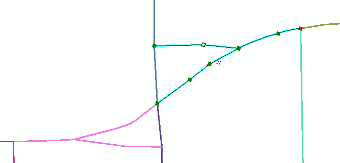

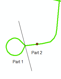

As you suggested, Feature To Point with the "Inside" option worked well thanks.
It seems to have placed the midpoint along the entire length of the line (all parts considered), which is what I wanted. It didn't just use the midpoint of a single part...such as the the first part it found (good).

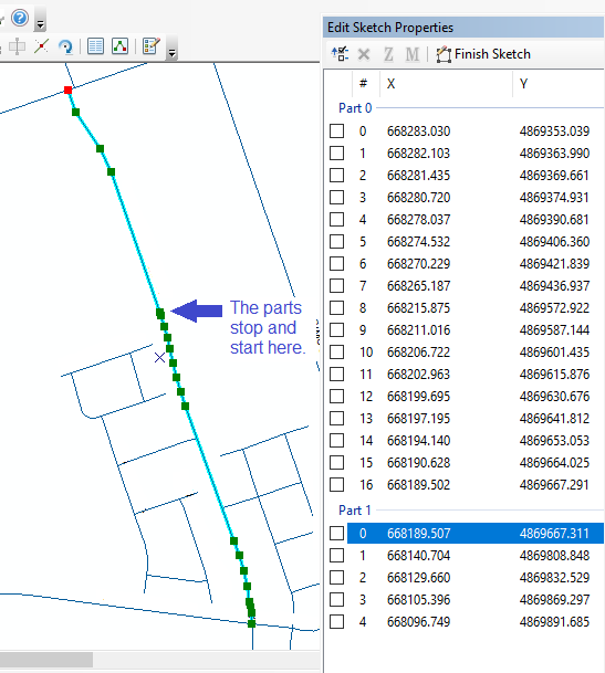

(The line in the screenshot is composed of multiple parts. That's incorrect/unnecessary, but beyond my control.)
Thanks for the tip about that GP tool.
Bud
Esteemed Contributor
Actually, on closer inspection, I don't think it placed the point halfway along the line. Maybe it did something else, like place the point in the middle of the envelope. Then snap the point to the line, to satisfy the "Inside" criteria.
