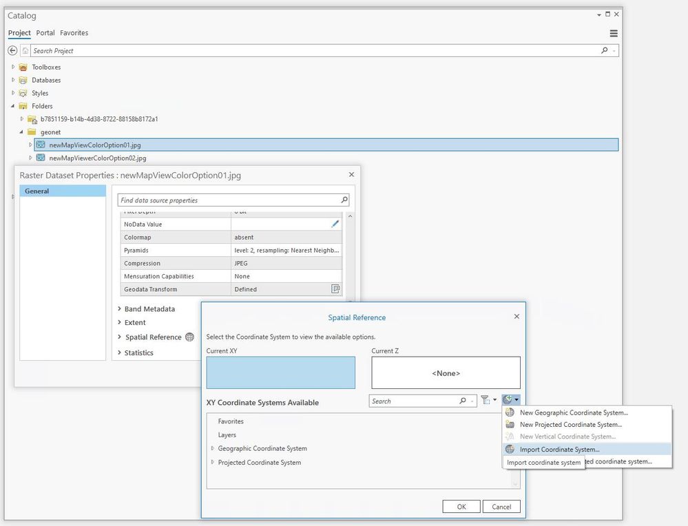

You could try deleting the projection information for the JPG. Basically, get it back to a projection as "undefined" and then you should be able to use the georeferencing tools.
When you look at the JPEG inside of Catalog, does it have a defined projection system? If it does, or even it it doesn't display one you can try this, Under the raster properties, there is an option to import projection information from another dataset (click that globe icon next to the Spatial Reference grouping in the main properties dialog).
Use any other JPG (a photo, a PDF converted to a JPG, etc) that doesn't have a defined projection and then use that image as a the source to re-apply an undefined projection back to your master plan JPG. I think that might do the trick.
