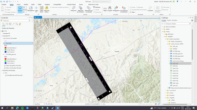

Hi! I saw that you were in this topic and I really need your help.
I have a image print of a seismic line of area of interest. And I want to visualize it vertically with the rest of the shapes 2D.  I inicially georreferenced only the two points that outcrops in the surface.
Can you guys explain to me how can I make the image perpendicular to the seismic path line?
Thanks in advance!
