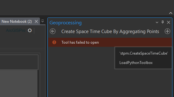

Hello Everyone, I keep getting this message whenever I try to use the "Create Space Time Cube By Aggregating Points" which has not happened before.
Geoprocessing Create Space Time Cube By Aggregating Points Tool has failed to open × 'stpm.CreateSpace TimeCube' Load Python Toolbox
Thank you guys for you support

PhilipNalla1
Thank you for your response. I had to restore all the temp files I deleted since they were in the recently deleted items, and it worked.
