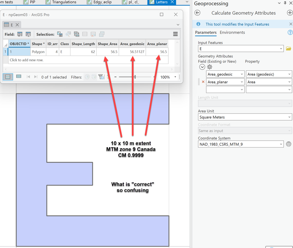

LL corner  300,000, 5,000,000
UR corner 300, 010, 5,000,010
MTM zone 9  (NAD_1983_CSRS_MTM_9)

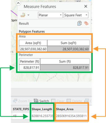

Thanks again for sharing. Accuracy, or measurement result differences, wasn't my original concern on this Post. However, now I'm starting to see some differences within the same measurement mode and projected coordinate system -- similar to what you illustrated. Also see my results below between the Measure tool and the Shape_geometry fields. ...Close, but not exact. Why not? ...Ok, I'll submit a Case to Esri Support to see what they say.
