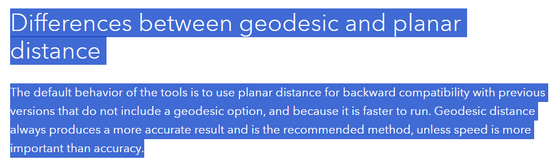

...What made me re-think this is when I read this in the Distance tool Help page (see below):
And then I opened that tool and saw the Distance measurement mode option (see below that):
And, now I see -- for example -- that for the vector equivalent, Proximity tools -- some of them provide the option (Geodesic or Planar) and some don't.  So, then I started wondering what the "default" is for the tools that do not offer the option..? Like you, my assumption is also "Planar", but this has certainly raised my eyebrow 😉

Thanks, Dan, but yes this is the information I had already read. ...For me, I then usually have very pointed questions I'm seeking answers for, like:
1) Why does that Help page say, "Geodesic distance always produces a more accurate result and is the recommended method, unless speed is more important than accuracy". Do note that this was referring to  the Raster > Distance tool, but makes me wonder about other other tools or vector analysis, like my other question:
2) Which measurement mode (geodesic or planar) is used in vector-based analysis?
If planar, why, if geodesic is ALWAYS more accurate? (see Question 1)

Craig_Eissler_Iceman
Thanks, Dan ...of course I'm just pointing out a Help page that Esri says geodesic always more accurate...
...which led me to my question (which I'm still not sure is answered), but I'll re-post again: "What measurement mode is used in the geoprocessing analysis tools?" Geodesic or Planar?
And if it matters, I'm asking from the vector-based, projected coordinate system perspective.
So, my assumption has always been that it is using 'Planar' measurements
...But, reading that Esri Help page is what had me question this...
