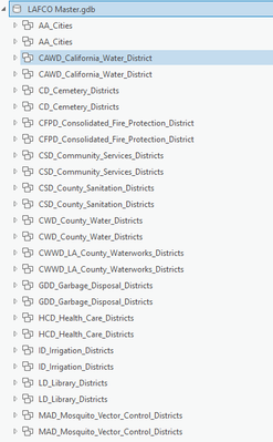

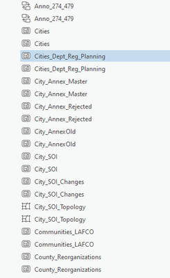

Hello,
Long story short, I reprojected my data into WGS 84 without realizing they would be exported into the same master source gdb, deleted the duplicates, but now see ghost duplicates of feature datasets and feature classes of what I deleted when first opening ARC Pro.

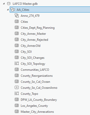

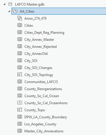

Refreshing the geodatabase removes said ghosts, however, I am afraid that this problem will carry over to my data backup dataset and online data were I to update them.
Since then I deleted the duplicate feature dataset for all duplicates; however I still see the 'ghost' of the feature datasets below the real one. This seems to be an intermittent issue and goes away when I refresh my geodatabase.
