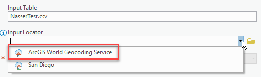

Actually, it is available and I just tested it again.
EricAnderson17
Thanks Nasser, so just to confirm, when you right-click the table > Geocode Table, and it opens the Geocode Table pane, you don't see an option for the "ArcGIS World Geocode Service" in the Input Locator drop-down?
Can you confirm what Active Portal you are using in ArcGIS Pro? If you go the blue "Project" button in the very top-left corner of ArcGIS Pro and hit the "Portals" tab, ensure that "https://www.arcgis.com/" is set as the active portal and this is the one you are signed in with. If you needed to switch to this portal from something else, it'd be good to restart Pro after changing it to re-load the locators.

NasserSharareh1
No, Eric, it is not there. I should click on the folder and search that term in the "All Portal", and still I don't find it.
I double checked that. ArcGIS.com is my only available portal and it is active.

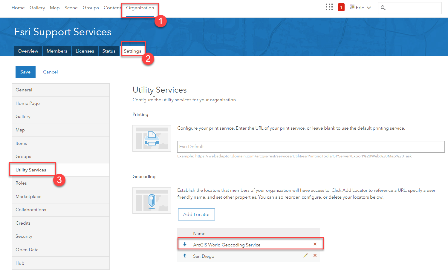

EricAnderson17
At this point it would probably be good to get in contact with one of the Administrators of the ArcGIS Online account you are using to sign into ArcGIS Pro with and ensure:
  1. You have a role with the "Geocoding" permission (most of the default roles will have this permission turned on, really only applies if your organization is utilizing custom roles)
  2. The ArcGIS World Geocode Service has been added to your organization settings
    1. Log into arcgis.com with Administrator credentials
    2. Organization tab > Settings > Utility Services
    3. If you don't see ArcGIS World Geocode Service listed, add it via "Add Locator"
