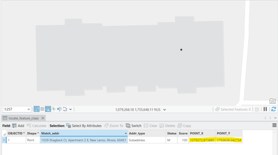

JonathanLebowitz
Hi Jared, below are the coordinates of the test address in Projected Coordinate System NAD 1983 StatePlane Illinois East FIPS 1201 (US Feet)/WKID 3435. This is pretty consistent with the coordinates in your table. They were computed with the Add XY Coordinates (Data Management) geoprocessing tool in ArcGIS Pro.
