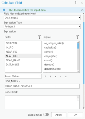

NEAR_DIST—The distance from the input feature to the near feature. The value of this field is in the linear unit of the input feature's coordinate system, or Meters when the Method parameter is set to GEODESIC and the input is in a geographic coordinate system.
Clearly, you are using a Geographic Coordinate System. You could calculate the Geodesic Distance (in Meters). Then add a new field "DIST_MILES" (Double). Using Calculate Field,
Expression:
!NEAR_DIST!/1609.34
Expression:
!NEAR_DIST!/1609.34
