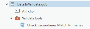

I've attached a geodatabase with the input feature class (AR_clip) and the script (Check Secondaries Match Primaries) within the ValidateTools toolbox.
Thank you for the assistance. Hope your team can shed some light on what the hang up is.
Kathleen
DanLee
by Esri Regular Contributor
I got the gdb, but not the ValidateTools toolbox with the script tool and source code. Could you share those?
KathleenMohla1
The toolbox should be in the gdb and the script within the toolbox.
Let me know if it's not there and I'll try and send it again.

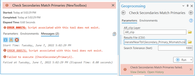

DanLee
I see the toolbox and the script tool, but when I tried to run with your input AR_clip, it says no associated script:
Could you share the py file? I can connect it to the tool by myself.
