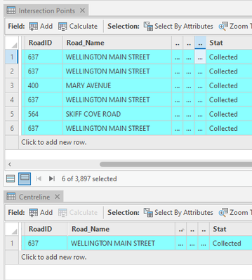

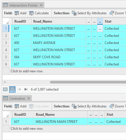

I would like to use modelbuilder and/or field calculator with arcade to extract To/From values at road intersections. I have 2 feature classes. A road centreline layer that is broken up at intersections and I used the Intersect tool to create points at each of the intersections containing the road names. How can I perform the following:
- iterate through the road centreline layer
- select points that intersect with each centreline
- for each point that has a Road_Name that is not the same as the centreline Road_Name, append each to the ToFrom field delimited by a comma (,)
For example, in my screen capture I would like the To/From field for my Wellington Main St. centreline to display MARY AVENUE , SKIFF COVE ROAD

That worked perfectly, thank you! I just reworked the last couple lines to remove duplicated road names on dead end roads (i.e. a dead end road that intersects wellington main st. would have a value of WELLINGTON MAIN ST, WELLINGTON MAIN ST)
// remove repeating road names i.e. for dead end roads
var unique_name = Distinct(road_names)
// concatenate and return
return Concatenate(unique_name, ", ")
