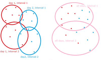

Sorry, I find it hard to describe, as English isn't my first language. Hopefully the illustration helps...
Imagine you have location data over two days (red and blue points).
The first code sample will give you the polygons on the left side: one polygon for each time interval on each day. "Where were you on day 1, interval 2?"
The second code sample will give you the polygons on the right side: one polygon for each time interval on all observed days. "Where were you on any day, interval 2?"

RZara
The illustration was very helpful. I'll give it a try.
