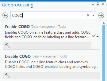

The GP Tool Enable COGO, adds the required attribute fields to a line feature class.
On the View tab click the Geoprocessing button:
On the Geoprocessing pane, click in the Search box and type COGO:

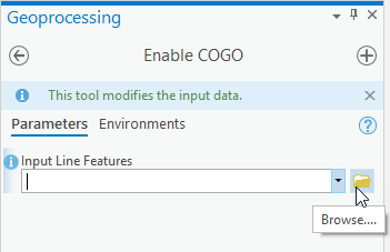

Start the Enable COGO tool
For the Input Line Features browse to the feature class:
Click Run.

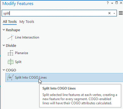

ArcGIS Pro 2.6 introduced a new tool that adds the ability to Split lines into COGO lines: https://pro.arcgis.com/en/pro-app/help/editing/split-lines-into-cogo-lines.htm

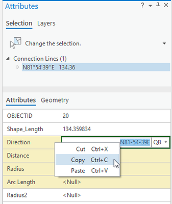

If you select a COGO line after its split, and open the Attributes pane, using the button on the Edit tab, then you can copy and paste the value from there:

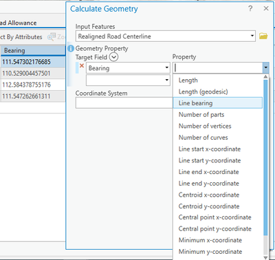

I added bearings to a line feature class today using this process:
right click the line feature class -> Design -> Fields
 Click here to add a new field -> name your field (I used the name bearing) -> save
Open the attribute table of the feature class, right click your bearing field and calculate geometry
then you can right click your feature class ->Data -> export table
