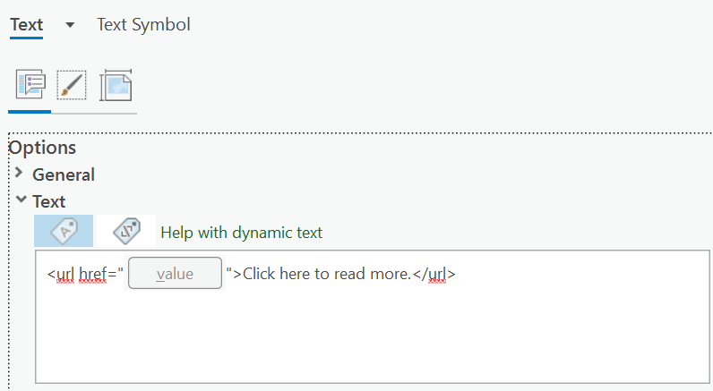

Further, setting the <url> tag before the dynamic element in the text properties makes this URL clickable on PDF export like so:
So far so good!
However, what I would like to do is to change the display of this clickable URL to read something like "Click here to read more" instead of the text of the URL itself. Like so: Click here to read more

Try this <url href="https://subtelforum.com?s=GTT%20Express">Click here to read more</url>

Hm, this didn't seem to work.
I should have probably clarified, the reason I need the expression to pull the URL together in the first place is because this needs to be a dynamic element in a map series.

I found that the URL is only clickable if the label is fully visible. It seems the PDF reader interpretes/recognizes the link and let the user navigate to that URL. ArcGIS Pro doesn't really support clickable links in its Layouts. Am I right?

No, I ended up with using a Python script and a 3rd party Python PDF library (pdfrw / pdf-annotate) to put all the links in the PDF.

my workaround for this was to set the text color to 'no color' (transparent) and place that element over a stylized text box. You can't see the text but they can still click it and the button looks like a hyperlink.
