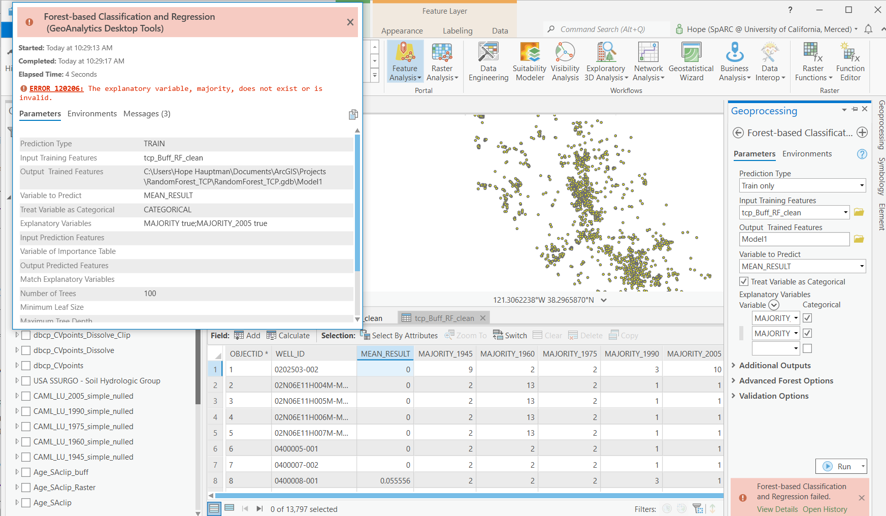

I am struggling with preparing data for the Forest Based Classification and Regression (FBCR) tool. I have point/polygon data with buffered contamination sites - that is the predictor variable. The multiple explanatory variables are from raster data but I have joined them in a table together with the point/polygon data.
So basically my table to run the FBCR tool looks like this (with error message):
When I run the tool I get an error - Explanatory variable does not exist. Could this be with the way I am naming the variables, the data type (long) or that I should not have joined the variables in the same table?
Can anyone speak to preparing data for the FBCR tool? Thank you for any information.

Did you make the join permanent by exporting it to a new shapefile/FC?
