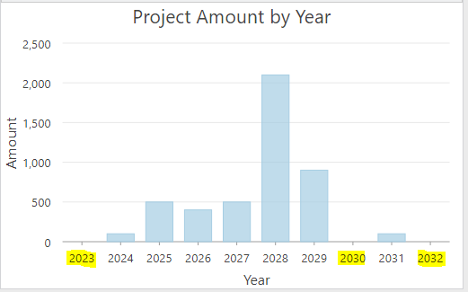

I have a standalone file geodatabase table called Projects. I've created a bar chart from the table.
That works, but I need bars in the bar chart for each year within a range: system year + 9.
In other words, I want bars for 10 years, starting with the current year (currently 2023).
So I need to force ArcGIS Pro to show empty bars for 2023, 2030, and 2032.
It would look like this:
I mocked that up by manually adding filler rows to the table (not the desired solution):
Question:
Is there a way to dynamically force the bar chart to show the missing years? (10-year range: system year + 9)
Thanks.

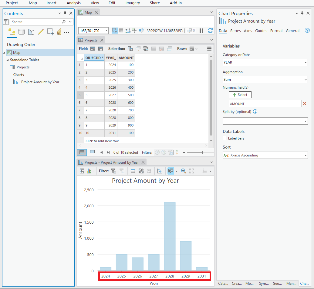

Hi @Bud , thanks for logging the Idea to support charts on mobile geodatabase views. We will look into this.
To address your original question, I just wanted to mention that converting the year to a Date type should fill in the empty years between the range of valid values (for example, 2030 in your case). This can be achieved with Calculate Field, which would update your attribute table.
Alternatively, in Pro 3.1 we will have the option to configure some chart parameters using Arcade expressions, which would allow you to convert the year to a Date type without needing to update the attribute table. For example, here I have a bar chart that's created on a "year" integer field. This chart is missing data for the year 1951, and since the field is an integer, the x-axis label is not shown for the missing year:
But in this example, I've converted the integer "year" field to a Date type using Arcade, and now the 1951 x-axis label is shown:
With respect to your question about filling in values that extend beyond the range of your data (in your case, 2023 and 2032), we are currently exploring solutions that would give users the ability define custom ranges.
Thanks for the feedback!
