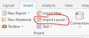

@JohnEsther2 I think this is grounds for an Idea, but for now, there is a really simple workaround.
Just share the layout as a layout file, then reimport the layout file back into your Pro project. Then the layout and associated maps get added back with a "1" tagged onto the end. Simples 🙂

There is no setting, but you can check yourself in the Project backstage, under Options.  All user configurable options are there
